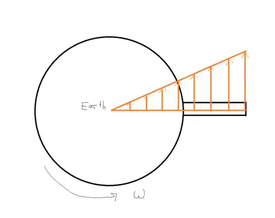

Consider a skyscraper on the equator of earth. I will draw a cross-section of the earth with the skyscraper from the view of the north pole: enter image description here
The earth-skyscraper system has an angular speed of $\omega$ = 2$\pi$/(24 hours). Consider the velocity distribution of material points belonging to the system along a radial line: enter image description here
As you can see, the top of the skyscraper moves faster than the ground from the inertial observer's point of view.

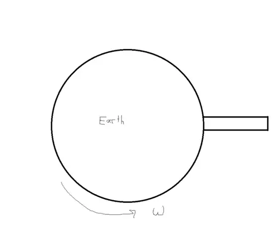

Suppose someone at the top of the skyscraper is in possession of a rock. Then that rock has the same velocity as the top of the skyscraper due to the earth's rotation. The observer lets go of the rock, subjecting the object to a gravitational force directed at the Earth's center.

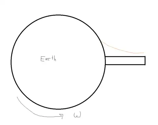

As the rock travels towards the ground, assuming no air resistance, it retains its original high lateral speed that it possessed at the top of the skyscraper and develops a radial speed towards the center of the earth. Therefore, when it reaches the ground, it will have traveled a distance towards the east, relative to the observer riding with the earth: enter image description here
Gravity actually complicates things a little in this thought experiment because the ball path according to the inertial observer is also curved. If you want to really hammer it down, there is a great example of two kids sitting opposite to one another on a merry-go-round. One kid passes a ball directly at the other. Why does the ball appear to deflect in the merry-go-round frame? How does the ball motion look from an inertial observer? Maybe you want to stare at the animation on this page for a while: https://en.wikipedia.org/wiki/Coriolis_force
