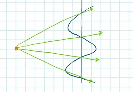

You are talking about the acousto-optical effect, that is lght diffracted by an acoustic wave. There are two regimes to this, Raman–Nath diffraction and Bragg diffraction.
Can you please clarify if there is or not diffraction phenomena?
Yes, there is diffraction.
You can think of this in two ways:
  • particle picture:
phonons (quanta of sound, black) propagate in the crystal and interact/collide/kick the photons (quanta of light, blue). By momentum conservation, light is deflected and it frequency shifted.
  • wave picture:
The sound (acoustic) wave propagating in the crystal is modulating the density of the material, which changes its refractive index. The optical length of light in a material depends on the refractive index, so there is a spatially dependent phase picked up by light. This is actually a phase grating, analogous to the usual amplitude diffraction grating that we all know -- instead of modulating the amplitude (light blocked, light let through), you modulate the phase. Then it's diffraction/interference pattern as usual.
