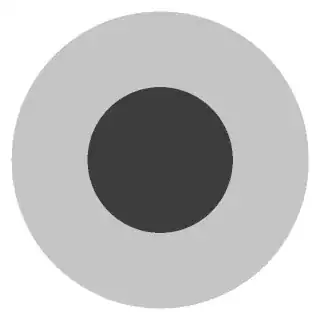

One of them (A), however, has most of its mass distributed near the center (heavy center, light shell),
A

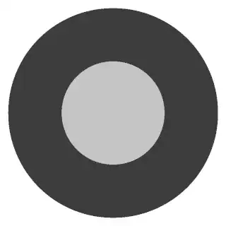

while the other (B) has most of its mass at the shell (light center, heavy shell).
B

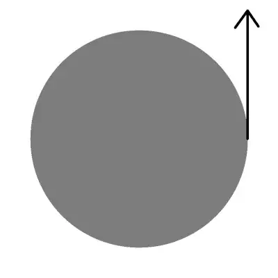

Now I apply a tangential force ($F$) to them (they are at rest, floating in empty space). (When the ball starts to move, let's assume the force will stay tangential to the ball, i.e., the spot on the ball's surface, that the force will be applied to, changes with rotation. So the directions of the force will continue to be the same as it was at the start.)
F
Assuming I put the same amount of work into both ($F \cdot s$), I guess A will spin faster than B, because of the different moments of inertia.
Also, both will not only gain rotation but translation too. Will they both have the same (translational) speed, or does the difference in mass distribution make a difference here too?

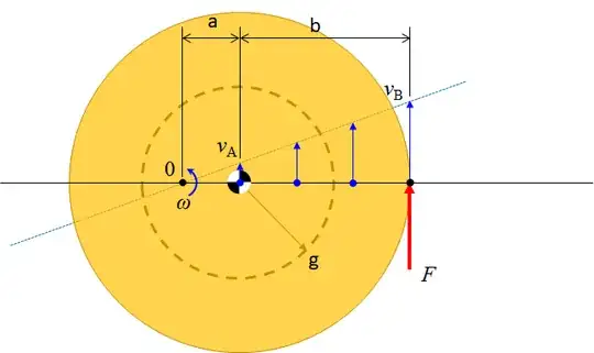

The two spheres differ by their mass moment of inertia and have the same mass, and thus differ by their radius of gyration $g$.
Now consider where the center of rotation is for this situation. In the figure below the COR is located at point 0.
fig1
There is a special relationship between the distance to the COR from the center of mass $a$ and the distance where the force (or impulse) is applied $b$. This relationship is always
$$ \boxed{ a = \frac{g^2}{b} } \tag{1}$$
This means that if the center of mass has velocity $v_A$, then the point where the force is applied must have velocity $v_B = \frac{a+b}{a} v_A$ or dependent on the ratio of geometric radius $b$ to radius of gyration $g$
$$v_B = \left( 1 + \left( \tfrac{b}{g} \right)^2 \right) v_A \tag{2}$$
Analysis
Consider the force applied for some small time $\Delta t$ and the equations of motion are $$ \begin{aligned} m \frac{v_A}{\Delta t} & = F \\ (m g^2) \frac{\omega}{\Delta t} & = b F \end{aligned}$$ which yields the relationship between linear and rotational speed $$ \omega = \frac{b}{g^2} v_A \tag{3}$$
Finally consider the total kinetic energy $K = \tfrac{1}{2} m v_A^2 + \tfrac{1}{2} I \omega^2$ equals the work done $W=F s$ where $s$ is the distance traveled by force and is fixed for both scenarios.
$$ F s = \tfrac{m v_A^2}{2} + \tfrac{m b^2 v_A^2}{2 g^2} \tag{4} $$
Use (2) to solve for $v_A$ and substitute above. Then solve for $v_B$ to get the tangential velocity after the force has traveled the distance $s$ as a function of $m$ and $g$
$$ v_B^2 = \frac{2 F s}{m} \left( \frac{b^2+g^2}{g^2} \right) \tag{5} $$
Also note that the speed of the center of mass is
$$ v_A^2 = \frac{2 F s}{m} \left( \frac{g^2}{b^2+g^2} \right) \tag{6}$$
$$ \omega^2 = \frac{2 F s}{m} \left( \frac{b^2}{g^2 ( b^2+g^2)} \right) \tag{7}$$
Summary
As radius of gyration $g$ increases ↑ (more mass towards the outside) the following happens:
  • The speed of the outer edge decreases ↓ (eq. 5)
  • The speed of the center of mass increases ↑ (eq. 6)
  • The spin decreases ↓ (eq. 7)
