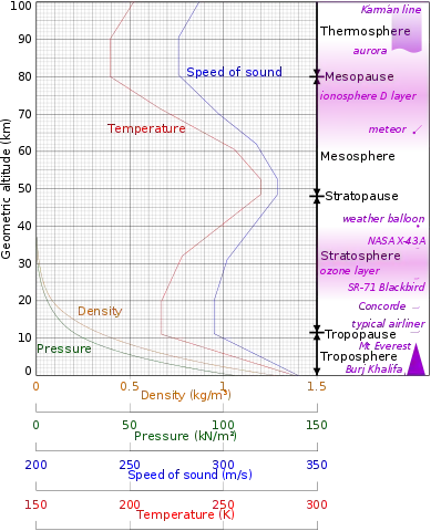

As for whether the speed of sound is nonlinear, Wikipedia's page on the Speed of Sound has a picture which shows that it is most decidedly nonlinear:
Atmospheric values with respect to altitude
