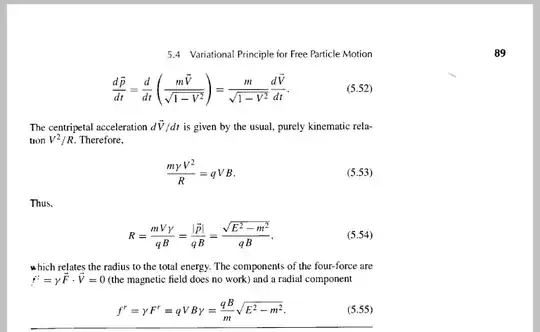

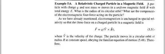

(1) You are using an incorrect expression for acceleration which is valid for classical cases only. That is, $\ a = \frac{\ v^2}{\ x}$ . The correct one is $\ a = \frac{\ v^2 \gamma}{\ x}$
These pages from Hartle's book Gravity will help. See example 5.6, equation 5.52 and whats written after it.

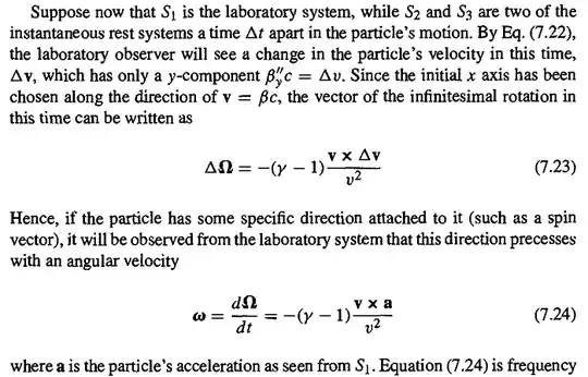

The thing is that the derivation of this formula implies that $\bf{\omega}_T$ describes additional precession due to relativistic effects:
Goldstein
Note that Jackson in the next equation adds $\bf{\omega}_T$ to $\frac{e\bf{B}}{mc}$ - precession due to magnetic field.
