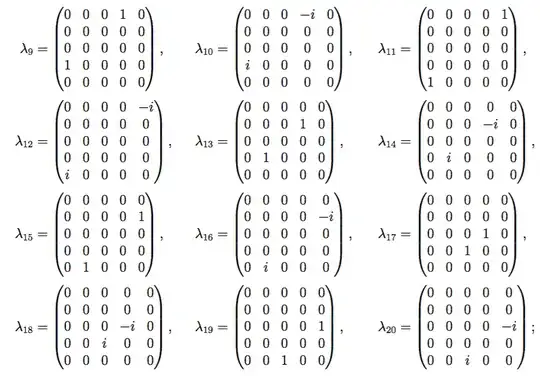

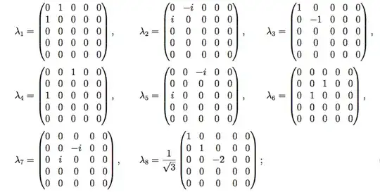

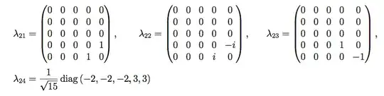

It is easy to write down the 5-dimensional matrix representations of $SU(5)$ with 24 Lie algebra rank-5 matrix generators as:
enter image description here enter image description here enter image description here
