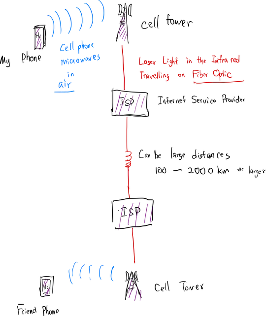

I have drawn a diagram to illustrate the mechanisms of how telecommunications work. This is a highly simplified cartoon of what happens. What I’ll be describing is in part often described in Telecom as Layer 0. All other layers have more to do with software than physics. That being said lets go through he parts.
  • Blue is for Microwaves sent from Cell Phone or Tower
  • Purple is for Electronics
  • Red is for Infra-Red laser light travelling through glass fiber optics.
  1. Cell phone sends microwaves (often 4G if you use say FB Messenger/WhatsApp ~ 2GHz in frequency)
  2. Cell phone tower receives it and interprets it electrically before sending the information in the form of modified laser light along glass fibers to an ISP (Internet Service Provider)
  3. The ISP (which has a building in each city) sends it to some other building they have via Laser light again. This next building could be very far (100km to 2000km and larger), basically where ever your friend is. Laser light is about 193 THz or 1550 nm.
  4. the Building send it to a cell tower via laser light again
  5. Cell tower talks to the cell phone via microwaves.

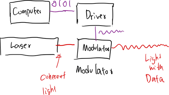

I have included another diagram on how the laser light is modified. Again, this is a highly simplified diagram.
  1. A computer that has data (binary 0 ,1) talks to a driver to send an electrical signal
  2. A laser light always turned on a specific frequency gives you very nice steady source of ~1550 nm Infrared light
  3. From 1) the electrical signal manipulate a driver that influences a modulator
  4. modulator is what controls the laser light and imparts data into it by modifying it’s phase or it’s power.
  5. Laser light finally travels downs glass fibers a few microns in diameter for a very long distance.

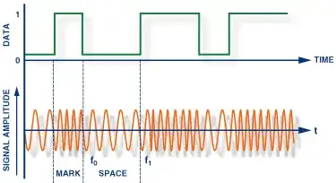

Or perhaps it's something like this
with 0 and 1 encoded as different frequencies. Or it might use some other scheme. In some sense, this is a physical layer equivalent of a data structure, and the encoding scheme must be agreed upon by the two ends so that the signal can be correctly interpreted as bits.
