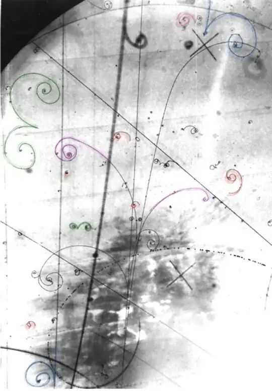

Here are real events relating to the last page of the pdf link you gave:
electromagnetic events
Fig.1 This bubble chamber picture shows some electromagnetic events such as pair creation or materialization of high energy photon into an electron-positron pair (green tracks), the Compton effect (red tracks), the emission of electromagnetic radiation by accelerating charges (violet tracks) (bremsstrahlung) and the knock-on electrons or delta ray (blue tracks)
Photons are invisible in bubble chambers as they interact only with direct collisions with electrons, called Compton scattering, or pair production in the field of a nucleus. Charge particles turn in the perpendicular to the plane magnetic field; this allow us to measure their momentum and charge and the ionisation of the tracks allows the identification of masses.
At the lower left of the picture, there is an electron( identified by its ionisation) which loses energy into a photon, and the photon pair produces some centimeters away, an electron positron pair.
in the middle right side, we see a positron that loses energy into a photon and the photon kicks an electron from the atoms of the chamber, this is a Compton scatter. This corresponds to the diagram in the last page of your link, except it has been reduced to one dimension. In reality there are two dimensions, because the photon gives part of its momentum/energy kicking at an angle . The following is the correct diagram kinematically:
compton
It should not be surprising that classical scatters and particle scatters kinematically are the same, because momentum and energy conservation hold both classically and quantum mechanically. It is the probability of interaction that is different in the microcosm of elementary particles to the billiard ball particle scattering. In simple scattering experiments the kinematics are not different ( except that special relativity holds in the microcosm).
Edit after edits in question. I think the image , from a real experiment, answers whether a photon can hit an electron or not.
