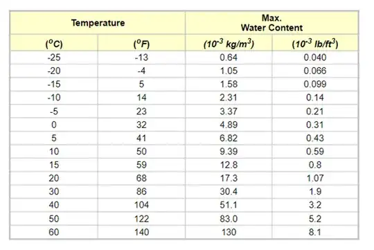

My home has 150 m3 air. I would like to calculate, that how much liters of water this air contains, if the temperature is 25 C° and the relative humidity is 60%. I would like to calculate it for 26 C° and 54% as well.

You could use this table that shows the maximum water content, it is for 100% humidity, then just adjust for the % humidity and multiply by the volume.
It's from https://www.engineeringtoolbox.com/maximum-moisture-content-air-d_1403.html
