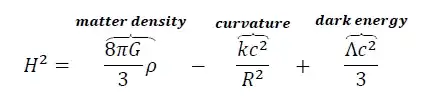

The Einstein equation is also the first Friedmann equation. So what the OP has done is write the de Sitter (dark energy only, no matter, flat universe) solution.
It is well known that the de Sitter characteristic length $l_\Lambda$ is related to the cosmological constant $\Lambda$:
\begin{equation} {\Lambda} = \frac{3}{l_\Lambda^2} \end{equation} That's the $1/r^2$
Now, working out the radius of the current observable universe does depend on what parameters you plug in (aka 'model dependent') but there is general acceptance the radius $R_{obs}\approx46Gly\approx 4.4\times10^{26}m$.
TLDR: So yeah, $2\pi l_\Lambda\approx2\times R_{obs}$. But the 'connection' ($\pi$) is just that the current recessional velocity of the particle horizon is $\approx3.47c$.
