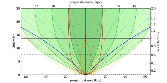

I'll expand a bit (no pun intended) on the answers given by Michael Brown and Ben Crowell. The expansion rate of the early universe was indeed much greater than it is today. The expansion decelerated first, and only started to accelerate again when the universe was 7.7 billion years old, due to the effect of dark energy. Furthermore, distant regions of space are receding from us faster than the speed of light: the Hubble law $$ v = HD $$ simply states that the recession velocity of a distant galaxy is proportional to its proper distance $D$. If $D$ is large enough, then $v$ exceeds the speed of light. The distance $D_H$ for which $v=c$ is called the Hubble distance, and is currently about 14.5 billion lightyears. However, this distance is much smaller than the radius of the observable universe, which is about 46.2 billion lightyears. Have a look at this graph, which displays the expansion of the universe:
The horizontal axis shows the distance to us (in Gigalightyears), and the vertical axis is the cosmic time (left), and the corresponding scale factor (right). We are located at the cross-section of the thick black lines; our universe is currently 13.8 billion years old.
The blue curve is the size of the observable universe, and the red curve is our event horizon. The yellow lines are the paths of photons; in particular, the orange lines are the paths of the photons that we observe today: our current past light cone. The black dotted lines are regions of space (clusters of galaxies) that are moving away from as the universe expands. Finally, the green curves are lines of constant recession velocity: from dark-green to light-green we have $v=c$ (the Hubble distance), $v=2c$, $v=3c$ and $v=4c$.
As you can see, the edge of the observable is currently receding from us at more than 3 times the speed of light.
When a photon is emitted in our direction from a region of space, it has to overcome the expansion of space in able to reach us: while it is travelling towards us, the amount of space through which it has to travel increases. It's like swimming upstream or running on a treadmill, and the result is that it takes photons much longer to reach us (and if they're too far away, they can't reach us at all).

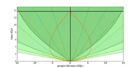

Let's zoom in on the graph: enter image description here
As I mentioned before, the orange lines are the paths of the photons that we observe today. Notice the characteristic teardrop shape: photons emitted in the early universe were emitted from regions that were receding from us faster than the speed of light. As a result, those photons were at first also moving away from us ($v-c>0)$. However, those photons gradually moved through regions that were receding at lower velocities, until they eventually crossed the Hubble distance (the dark-green curve), the region that recedes at $v=c$. This happened when the universe was about 4.1 billion years old. After that, the photons were fast enough to overtake the expansion of space, and their distance to us decreased, until they finally reach us today.
