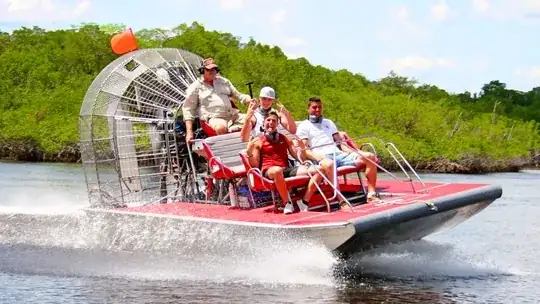

A fan mounted on a boat can make the boat move.
It works best without a "sail" messing up the air flow, but if the sail merely re-directs the airflow without introducing too much turbulence, then there's no reason why it should not work.
It probably will work best if the fan and the sail are oriented such that the air flow is directed astern, and directly in-line with the boat's keel.
