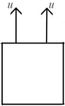

Case 1: Two strings are pulled with the same $u$ velocity. The box will also move with velocity $u$.
velocity

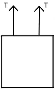

Case 2 : Tension along $\text{a}$ string is $T$. Therefore total force acting on the box is $T+T=2T$. (Box is accelerating)
force
I think my problem is obvious. Both velocity and force are vectors. But why we can not get the velocity of the box in the first case as $u+u=2u$? (This is obviously wrong, but why?)

Two strings are pulled with same velocity $u$. The box will also move with velocity $u$.
You don't "pull" a box with a velocity. You can pull it by applying a force that results in a change of velocity. Imagine you have two forces acting on the box, one that gives it a velocity $\vec v$ and the other gives it a velocity $\vec w$. Then it is okay to say that the resulting velocity is $\vec v +\vec w$.

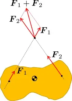

Now for the vector algebra part of the question. How do we add two forces or two velocities and how does this process differ.
  • Two Forces add up to the loading state of the body, by sliding the vectors along their line of action until they meet at a common point. At the common point use the trapezoidal rule to find out the direction, magnitude and location of the resultant force.
Fadd
The result is the vector addition of the axis vectors (Forces) and the moment vectors (Torques) component by component.
