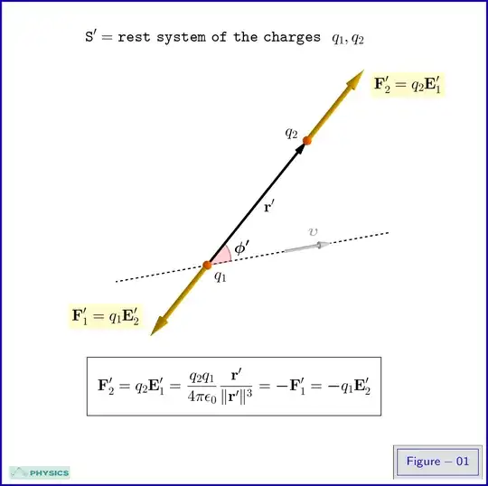

Consider two electric charges $\:q_1\:$ and $\:q_2\:$ at rest with respect to an inertial system $\:\texttt S'$, see Figure-01. One charge feels only the electrostatic Coulomb force of the other. Fields and forces are as follows \begin{align} \texttt{field of charge }q_1\texttt{ in }\texttt S' :\quad\mathbf E'_1 &\boldsymbol{=}\boldsymbol{+}\dfrac{q_1}{4\pi\epsilon_0}\dfrac{\mathbf r'}{\Vert \mathbf r' \Vert^3}\,, \quad \mathbf B'_1\boldsymbol{=0} \tag{A-01a}\label{A-01a}\\ \texttt{field of charge }q_2\texttt{ in }\texttt S' :\quad\mathbf E'_2 &\boldsymbol{=}\boldsymbol{-}\dfrac{q_2}{4\pi\epsilon_0}\dfrac{\mathbf r'}{\Vert \mathbf r' \Vert^3}\,, \quad \mathbf B'_2\boldsymbol{=0} \tag{A-01b}\label{A-01b}\\ \texttt{force on charge }q_1\texttt{ in }\texttt S' :\quad\mathbf F'_1 & \boldsymbol{=}q_1\mathbf E'_2 \boldsymbol{=}\boldsymbol{-}\dfrac{q_1q_2}{4\pi\epsilon_0}\dfrac{\mathbf r'}{\Vert \mathbf r' \Vert^3} \tag{A-01c}\label{A-01c}\\ \texttt{force on charge }q_2\texttt{ in }\texttt S' :\quad\mathbf F'_2 & \boldsymbol{=}q_2\mathbf E'_1 \boldsymbol{=}\boldsymbol{+}\dfrac{q_2q_1}{4\pi\epsilon_0}\dfrac{\mathbf r'}{\Vert \mathbf r' \Vert^3} \tag{A-01d}\label{A-01d} \end{align}

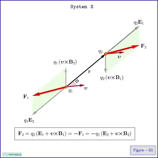

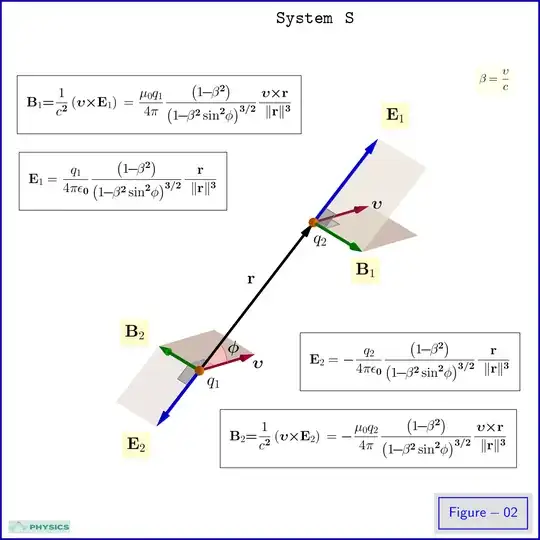

Consider two electric charges $\:q_1\:$ and $\:q_2\:$ in motion both with common uniform velocity $\,\boldsymbol{\upsilon}\,$ with respect to an inertial system $\:\texttt S$. The electromagnetic fields and forces are shown in Figure-02 and Figure-03 respectively. Derived from the relativistic Liénard–Wiechert potentials are as follows \begin{align} &\texttt{field of charge }q_1\texttt{ in }\texttt S : \nonumber\\ \mathbf E_1 & \boldsymbol{=}\boldsymbol{+}\dfrac{q_1}{4\pi \epsilon_0}\dfrac{\left(1\!\boldsymbol{-}\!\beta^2\right)}{\left(1\!\boldsymbol{-}\!\beta^2\sin^2\!\phi\right)^{3/2}}\dfrac{\mathbf{{r}}}{\:\:\Vert\mathbf{r}\Vert^3}\,, \quad\mathbf B_1\boldsymbol{=}\dfrac{1}{c^2}\left(\boldsymbol{\upsilon}\boldsymbol{\times}\mathbf E_1\right) \tag{B-01a}\label{B-01a}\\ &\texttt{field of charge }q_2\texttt{ in }\texttt S : \nonumber\\ \mathbf E_2 & \boldsymbol{=}\boldsymbol{-}\dfrac{q_2}{4\pi \epsilon_0}\dfrac{\left(1\!\boldsymbol{-}\!\beta^2\right)}{\left(1\!\boldsymbol{-}\!\beta^2\sin^2\!\phi\right)^{3/2}}\dfrac{\mathbf{{r}}}{\:\:\Vert\mathbf{r}\Vert^3}\,, \quad \mathbf B_2\boldsymbol{=}\dfrac{1}{c^2}\left(\boldsymbol{\upsilon}\boldsymbol{\times}\mathbf E_2\right) \tag{B-01b}\label{B-01b}\\ &\texttt{Lorentz force on charge }q_1\texttt{ in }\texttt S : \quad\mathbf F_1 \boldsymbol{=}q_1\left(\mathbf E_2\boldsymbol{+}\boldsymbol{\upsilon}\boldsymbol{\times}\mathbf B_2\right) \tag{B-01c}\label{B-01c}\\ &\texttt{Lorentz force on charge }q_2\texttt{ in }\texttt S : \quad\mathbf F_2 \boldsymbol{=}q_2\left(\mathbf E_1\boldsymbol{+}\boldsymbol{\upsilon}\boldsymbol{\times}\mathbf B_1\right) \tag{B-01d}\label{B-01d} \end{align}
where \begin{equation} \beta\boldsymbol{=}\dfrac{\upsilon}{c} \tag{B-02}\label{B-02} \end{equation}

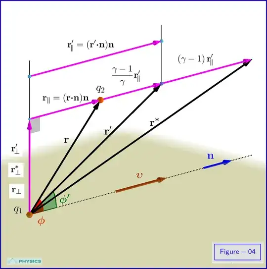

From equation \eqref{C-07} and Figure-04 we have \begin{align} \Vert\mathbf r\Vert^2 & \boldsymbol{=}\Vert\mathbf r'\Vert^2\boldsymbol{+}\left(\dfrac{\gamma\boldsymbol{-}1}{\gamma}\right)^2\underbrace{\Vert\left(\mathbf r'\boldsymbol{\cdot} \mathbf n\right)\mathbf n\Vert^2}_{\Vert\mathbf r'\Vert^2\cos^2\phi'} \boldsymbol{-}2\left(\dfrac{\gamma\boldsymbol{-}1}{\gamma}\right)\underbrace{\left(\mathbf r'\boldsymbol{\cdot} \mathbf n\right)^2}_{\Vert\mathbf r'\Vert^2\cos^2\phi'} \boldsymbol{\implies} \nonumber\\ \Vert\mathbf r\Vert^2 & \boldsymbol{=}\Vert\mathbf r'\Vert^2\left[1\boldsymbol{-}\left(1\boldsymbol{-}\dfrac{1}{\gamma^2}\right)\cos^2\phi'\right] \boldsymbol{\implies} \nonumber \end{align} \begin{equation} \Vert\mathbf r\Vert^2\boldsymbol{=} \Vert\mathbf r'\Vert^2\left(1\boldsymbol{-}\beta^2\cos^2\phi'\right) \tag{Pr-01}\label{Pr-01} \end{equation} From the normal components equality $\:\mathbf r_{\boldsymbol{\perp}}\boldsymbol{=}\mathbf r'_{\boldsymbol{\perp}}\:$ we have \begin{equation} \Vert\mathbf r\Vert^2\sin^2\phi\boldsymbol{=} \Vert\mathbf r'\Vert^2\sin^2\phi' \tag{Pr-02}\label{Pr-02} \end{equation} that is \begin{equation} \cos^2\phi'\boldsymbol{=}1\boldsymbol{-}\dfrac{\Vert\mathbf r\Vert^2}{\Vert\mathbf r'\Vert^2}\sin^2\phi \tag{Pr-03}\label{Pr-03} \end{equation} Inserting this expression of $\:\cos^2\phi'\:$ in equation \eqref{Pr-01} and solving with respect to $\:\Vert\mathbf r\Vert^2/\Vert\mathbf r'\Vert^2\:$ we find \begin{equation} \dfrac{\Vert\mathbf r\Vert^2}{\Vert\mathbf r'\Vert^2}\boldsymbol{=}\dfrac{1\boldsymbol{-}\beta^2}{1\boldsymbol{-}\beta^2\sin^2\phi} \tag{Pr-04}\label{Pr-04} \end{equation} so \begin{equation} \dfrac{\Vert\mathbf r\Vert^3}{\Vert\mathbf r'\Vert^3}\boldsymbol{=}\dfrac{\left(1\boldsymbol{-}\beta^2\right)^{3/2}}{\left(1\boldsymbol{-}\beta^2\sin^2\phi\right)^{3/2}}\boldsymbol{=}\dfrac{\sqrt{1\boldsymbol{-}\beta^2}\left(1\boldsymbol{-}\beta^2\right)}{\left(1\boldsymbol{-}\beta^2\sin^2\phi\right)^{3/2}}\boldsymbol{=}\dfrac{\gamma^{\boldsymbol{-}1}\left(1\boldsymbol{-}\beta^2\right)}{\left(1\boldsymbol{-}\beta^2\sin^2\phi\right)^{3/2}} \tag{Pr-05}\label{Pr-05} \end{equation} or \begin{equation} \dfrac{\gamma}{\Vert \mathbf r' \Vert^3}\boldsymbol{=} \dfrac{\left(1\boldsymbol{-}\beta^2\right)}{\left(1\boldsymbol{-}\beta^2\sin^2\!\phi\right)^{3/2}}\dfrac{1}{\Vert\mathbf r\Vert^3} \tag{Pr-06}\label{Pr-06} \end{equation} proving equation \eqref{C-13}.
