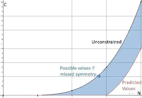

However, for $N\ge3$, I believe constraint (5) is linearly independent of the four symmetries and so the number of independent generally non-zero components $C$ will be:
$$C=\begin{cases}0,&N\in\left\{1,2\right\}\\\displaystyle\frac{1}{2}\left(N+1\right)\left(\frac{1}{6}N^2\left(N-1\right)-N\right),&N\ge3\\\end{cases}$$
However, if I have missed any uses of the above four symmetries for $N\ge3$ (please let me know in the comments) there will be less linearly independent equations and so $C$ will increase, but must still be bounded by $C\le\frac{1}{12}N^2\left(N^2-1\right)$. Therefore, the looser bound on $C$ is:
$$\frac{1}{2}\left(N+1\right)\left(\frac{1}{6}N^2\left(N-1\right)-N\right)\le C\le\frac{1}{12}N^2\left(N^2-1\right)\quad\text{for }N\ge3$$
These bounds are plotted below:
Thus, in 3D spacetime, $C=0$ and interestingly 4D spacetime (in which we live) has the first non-zero $C=10$.
