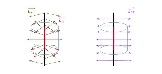

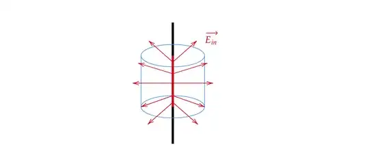

This is not true in general. In the example of an infinitely long charged wire, the correct Gaussian surface to use is a cylinder which is coaxial with the wire, as you have said. However, if you only consider only the field $\vec E_{in}$ generated by the charge enclosed by this Gaussian surface, it will not have cylindrical symmetry.
Gauss' law will still apply, of course. You could in principle compute the total flux through the Gaussian cylinder by only considering the charges inside. However, since the field due to the charges varies both in magnitude and direction over the surface of the cylinder, there is insufficient symmetry for this approach to be helpful in computing what $\vec E_{in}$ actually is at any specific point.
More to the point, our goal here is not to find $\vec E_{in}$ but rather to find the total field $\vec E_{tot}$ due to the charges along the entire wire, not just inside the Gaussian cylinder. $\vec E_{tot}$ does have cylindrical symmetry, which is why we can use Gauss' law to compute it without doing any difficult integrals.
And since we know that the net flux in the Gaussian surface is of the inside charge this suggests that the electric field ⃗ we will get after solving the integral (assuming symmetry) is the field of the charge inside the wire.
This is not true either. If a charge is sitting outside your Gaussian surface, then it's true that the field it generates does not contribute to the net flux through your surface. However, it most certainly does contribute to the total electric field at every point; it's just that when you integrate its contributions to the total flux over the full surface, it contributes positive flux in some areas and negative flux in others such that overall it sums to zero.
The total external flux $\iint \color{green}{\vec E_{out}} \cdot d\vec A = 0$, but that doesn't mean that $\color{green}{\vec E_{out}}$ doesn't contribute to the total field $\color{purple}{\vec E_{tot}}$ at every point. Since $\color{purple}{\vec E_{tot}}$ is what has the cylindrical symmetry, it is the field we are able to pull out of the integral and solve for using Gauss' law.
In other words, it is true that $\iint \color{red}{\vec E_{in}}\cdot d\vec A = q_{in}/\epsilon_0$ and it is true that $\iint \color{purple}{\vec E_{tot}} \cdot d\vec A = q_{in}/\epsilon_0$, but it is only in the latter case that we have sufficient symmetry to actually solve for the field. The first equation remains true, but is not very helpful for what we're attempting to do here.
