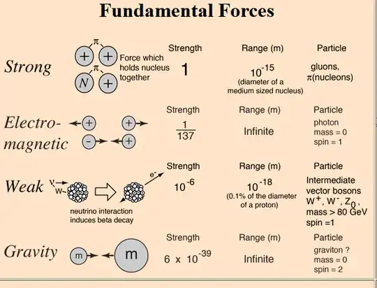

The effects are called interactions, there there are four interaction forces. Gravity we can ignore at the particle level, but there is the electromagnetic, the weak, and the strong, each described with its own strength. How probable it is that a particle hitting another particle will interact depends on the strength the couplings .

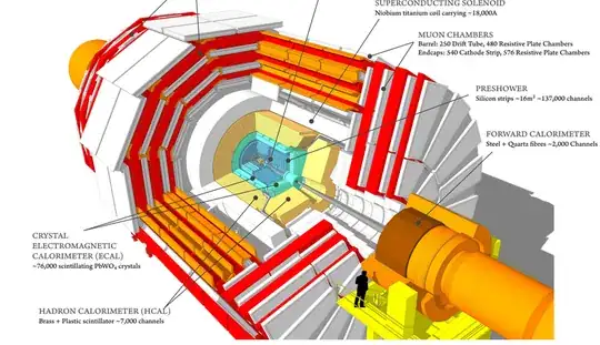

Take the cms detector:
cms
The figure of the man gives a feeling for the size, and the complexity is evident. That is why it takes thousands of people from all over the world to build, maintain , and analyze such experiments. How the particles are detected is analyzed in the link. The Higgs CMS paper was authored by over 5000 people.
