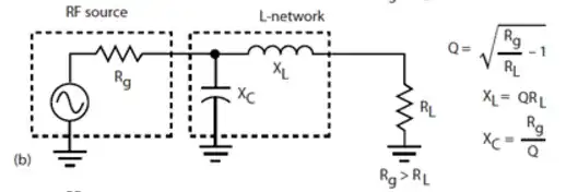

But if we are driving with a 50 Ohm cable, and our antenna represents a much smaller "resistance", then most of the power would be reflected and we don't get a good coupling of power into the antenna (remember - because of reciprocity, everything I say about transmitting is true for receiving... but intuitively the transmission case is so much easier to grasp). So to get good efficiency, we need to make sure there is an impedance match between our antenna and the transmitter / receiver.
If you know what frequency you are working at, impedance matching can be done with a simple LC circuit: the series LC represent a low impedance to the antenna, but a high impedance to the receiver. In the process, they convert the large current in the antenna into a large voltage for the receiver (source of image and detailed explanation)
This is an example of resonant matching: it works well at a specific frequency. One can use signal transformers to achieve the same thing over a wider range of frequencies - but this loses you some of the advantages of resonance (all frequencies are amplified equally).
