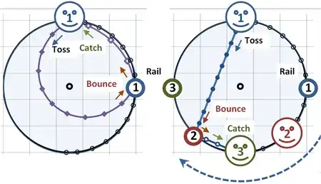

You could call the first law a 'test' for the remaining two laws; if the first law doesn't hold you can't apply the other two. For example in a rotating reference frame an inertial path could look like the left picture:
The ball is obviously accelerating but there doesn't seem to be anything causing the force. You have two options in this situation. You could argue there is no force on the ball (I don't see anything causing a force!) and in that case Newton's first law would be violated because the ball is still accelerating. You could also argue that there is a force on the ball defined by $\mathbf F\equiv m\, \mathbf a$. In that case Newton's third law would be violated because there is no second force that is equal and opposite to $\mathbf F$. This violates momentum conservation and we have no choice but to call this force fictitious. Either way we conclude our reference frame is non-inertial.
