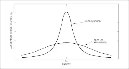

The only sense in which direction matters is for a phenomenon known as Doppler broadening. At finite temperature, the atoms are moving around at random - some will move away from the detector, others towards. When you plot light intensity against frequency, this broadens the peak you get:
broadening
