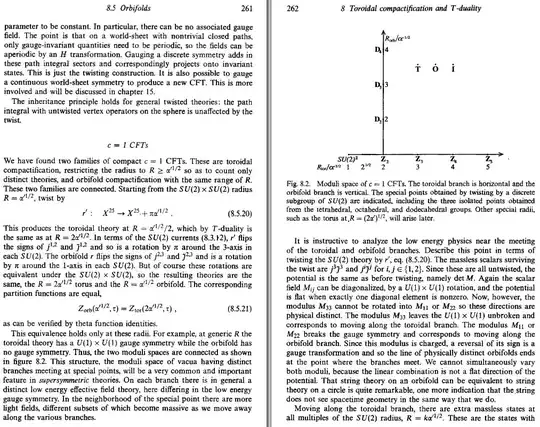

If you want to be sure about all the $c=1$ CFTs, pages 261-262 of Joe Polchinski's book, volume I, may be helpful. They approximately look like this:
