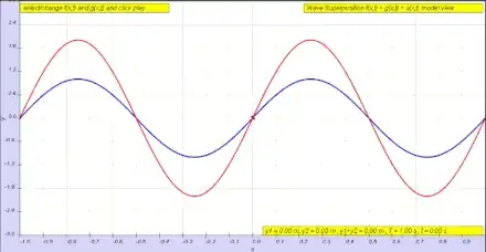

Wiki shows the fundamental and first overtone frequencies as follows. I'm trying to relate these to a vibrating guitar string and interference. I'm assuming these animated images represent the string after interference of two separate waves in opposing directions, but am having trouble visualizing this using the upper left image. Can anyone explain the phenomenon?
Standing Waves
Interference

If you look at the red wave, the section between $x=-1$ and $x=-0.5$, that part is the upper left image.
The second diagram at the top is like the red wave between $x=-1$ and $x=0$, and the third diagram is like the red wave between $x=-1$ and $x=0.5$ etc...
It happens like this because for the fundamental mode (the simplest vibration that is fixed at both ends), half a wavelength fits between the fixed points. For the first overtone (the second simplest vibration that is fixed at both ends), a full wavelength fits between the fixed points, and so on.
