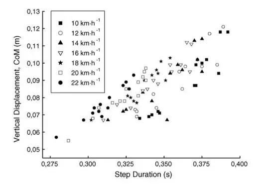

I claimed above that jumping is a poor model and this became a bit questioned in comments so I wanted to check myself since biophysics so often challenges my common sense. To that point one interesting paper I found was Gullstrand et al. (2009) “Measurements of vertical displacement in running, a methodological comparison.” Gait & Posture 30: 71-75 (link), which is mostly about a different topic, basically whether you can use a reflector or accelerometer in lieu of a sophisticated center-of-mass model to find vertical displacement during running. Figure 4 of that paper is:
A graph of different college-aged runners’ vertical displacements of their centers of mass during running,  vs their stride duration, broken down with different icons for different treadmill speeds. Each speed has a considerable amount of individual variability, but there is a net trend upward, slower speeds correlate with higher vertical displacement and longer step durations.
Fig. 4. The relation between step duration (s) and CoM Vdisp (m) for each subject at all running velocities.
This is a really fascinating figure and I had to stare at it for a little while. The first exciting thing to look at is how close all of the step durations are. Almost all of the data is between 300 ms and 375 ms, or 200 steps/minute at fast speeds to 160 steps/minute at slow speeds. We double the speed but the step rate only increases by 25%, I would have expected more! So this means that running faster is actually a function of increasing the stride length moreso than moving your legs faster, but moving your legs faster is certainly part of it.
But to our question, the vertical displacement of the center of mass is a direct measurement of gravitational energy during a step, and so if I divide by step duration I get a power exerted to fight “jumping” motion. So on the fast side I see the point (310 ms, 75 cm) as being in the middle of the cluster of high-speed runs, that ratio is something like 24 W/kg while maybe (370 ms, 100 cm) is more distinctive of the slower-speed, something more like 28 W/kg.
So based on these measurements, I have kind of two conclusions. First one is, “that is a lot!” ... These runners are presumably at least 50 kg so the power exertions in fighting gravity are around a kilowatt of power! Just for comparison, the baseline metabolism is an order of magnitude lower: 2000 kcal/day is about 100 W, some advice in the internet says to get an hour of exercise in the 50-150 W range, so exercise is usually lower than this as well.
But the other observation is, it seems that at higher speeds you are actually fighting gravity less per unit of time, something like 15% less power exerted at double the speed. Now, a caveat, the central purpose of the paper in including this figure is to argue that runners are more sloppy at slower speeds: so some amount of this is due to individual variability rather than some physical constraint of the problem. So I don't feel comfortable saying “we know that you fight gravity less at higher speeds” as some sort of statement of the biophysics of the problem, I can certainly imagine that trained runners are essentially 15% more sloppy when running at slower speeds than at high speeds.
But either way, it's not 100% higher or whatever, like you might expect if this vertical displacement mechanism were to explain our exhaustion during running. Flat or decreasing seems supported by the evidence, steeply increasing is required for it to be a candidate explanation. So what this points to instead is a huge amount of power being stored and released elastically in our leg muscles and joints.

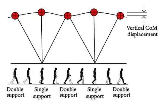

Cause 1: The fundamental reason for the difference observed: Jumping
Contrary to the wheeled motion, motion with legs do have a vertical component. Let $r$ be the length of your leg measured from hip to ankle. If you start straight up with your legs stretched, your center of mass (approximately at one’s belly button) will be at height $h_0$. At the moment your front ankle touches the ground with your feet maximally separated, your center of mass will “fall” to the position $h_1$ by the amount
$$\Delta h=h_0 – h_1=r(1-\mathrm{cos (\alpha)}) \tag{1}$$
Where $\alpha$ is the angle formed by your legs and the normal line to the ground. This fall costs you nothing. It is at gravity’s expenses. However, to recover your height at the middle of your gait you need to use muscle force and “climb” back to $h_0$. This procedure repeats itself at each step, and due to this, the motion of one’s center of mass looks-like an up-and-down wave (see dotted line in the image below). Even thought you still at ground level, after $n$ steps you have climbed (and felled) an equivalent height of
$$h=n \Delta h \tag{2}$$
Motion with legs involves a vertical up-and-down, wave-like component which is the basic responsible for walking energy consumption: See dotted line. Motion with legs includes a vertical up-and-down, wave-like component which is the basic responsible for walking energy consumption: See dotted line. From: “Three-Dimensional Gait Analysis Can Shed New Light on Walking in Patients with Haemophilia“, Sebastien Lobet et al, No changes made to the image
And performed a work of
$$W=n \times mg \times \Delta h \tag{3}$$
Where $mg$ is the person weight and $\Delta h$ is the average vertical displacement of the person’s belly button at each step. From $(3)$ you can see that the energy expenditure depends on the total number of steps and on person's weight (as expected). This dependence on weight explains why women accounted for less energy expenditure after the exercise in the paper. It happened because they were lighter, notice that the ratio between the average weight for man by the average weight for women ($76.6 \, \mathrm{kg} / 63.9 \, \mathrm{kg} \approx 1.2$) is the same as the ratio of average energy expenditure for man by the average energy for women ($520.6 \, \mathrm{kJ}/ 441.1 \, \mathrm{kJ} \approx 1.2$).
During a run, this pattern (the vertical motion) considerably increases, becoming little jumps. The ratio of the work done running vs walking is
$$\frac{W_{ walk }}{W_{run }}=\frac{n}{N} \frac{\Delta h_{walk }}{\Delta h_{ run}} \tag{4}$$
Where $N$ is the total number of steps done running.
From this, this and this papers we get $\Delta h_{walk} \approx 5 \, \mathrm{cm}$, $\Delta h_{run} \approx 12 \, \mathrm{cm}$ , $n \approx 2352^1$, $N \approx 1882^1$ therefore $$W_{ walk } \approx 0.52 \, \times W_{ run} \tag{5}$$ In other words, walking accounts for only $52\%$ of the energy expended by running the same distance. This is exactly what was found in the paper (males: $54\%$, females: $52\%$). As you see equation $(3)$ fully explains all the difference found in the paper, including the difference in energy expenditure for males and females. Still, in the paper the run only took approximately $10$ minutes. For longer runs a second effect will probably start make a big difference. This effect is
