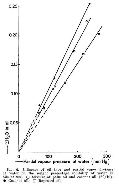

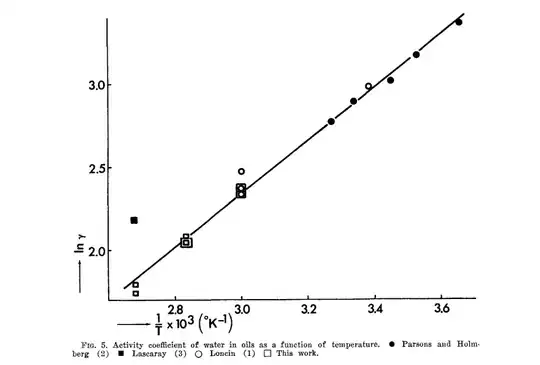

Could water solved in oil be the target of microwave heating?
Sure. Actually, Bo and Nyfers suggest this method as a way of detecting water dissolved in oils, important question in fuel industry.
The dielectric properties of a mixture of oil and water are determined by the permittivity and the relative volume fractions of each the constituents and of the structure of the mixing.
The Bruggeman formula is one such formula that is known to represent real water/hydrocarbon mixtures with a high accuracy

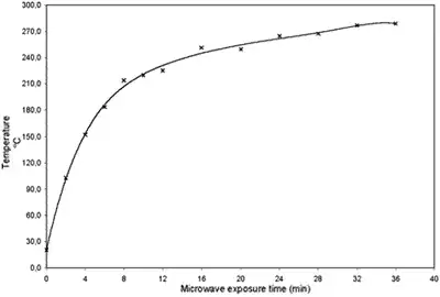

Degradation of Canola Oil in a microwave oven
After all, Canola Oil (or the components of its degradation) definitively heats up in a microwave oven:

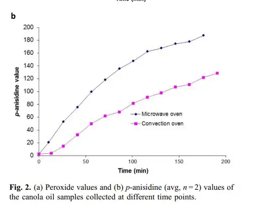

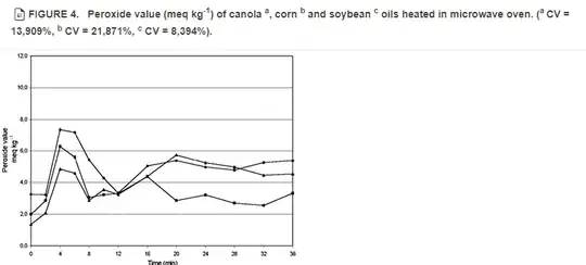

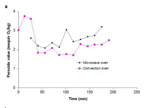

  2. Oxidative Stability and Degradation:
    • The study found that microwave heating causes oxidative degradation in canola oil, as evidenced by the increase in absorptivity at 232 nm and 270 nm. These wavelengths correspond to the formation of conjugated dienes and trienes, respectively, which are products of lipid oxidation. enter image description here
    • Absorptivity at 232 nm (submitted to this frequency for spectrographic analysis) increased significantly after 12 minutes of microwave exposure, indicating an increase in oxidation products. Similarly, absorptivity at 270 nm, indicative of secondary oxidation products like unsaturated ketones and aldehydes, also increased .
  3. Peroxide and Acid Values:
    • Peroxide value is a measure of primary oxidation products, specifically hydroperoxides. The peroxide value for canola oil initially increases during the first 6 minutes of microwave heating but then shows instability due to the decomposition of hydroperoxides at high temperatures.
    • Acid value, which indicates the presence of free fatty acids resulting from hydrolytic degradation, also increases with microwave heating. This suggests that both oxidative and hydrolytic degradations occur during microwave heating . enter image description here

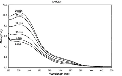

  4. UV-Spectrophotometric Analysis:
    • UV-spectrophotometry is used to monitor the oxidative stability of canola oil by measuring absorptivity changes at specific wavelengths (232 nm and 270 nm). This method is effective in detecting both primary and secondary oxidation products and provides a clear indication of the extent of degradation .
  5. Experimental Conditions and Observations:
    • The study heated canola oil samples in a microwave oven (800 W, 2,450 MHz) for varying periods, up to 36 minutes. It was observed that temperature changes and the extent of degradation were similar across different vegetable oils (canola, corn, and soybean), highlighting that microwave-induced oxidation is a general phenomenon for these oils.
    • It was also noted that the specific conditions of the microwave heating, such as power and exposure time, significantly affect the rate and extent of lipid oxidation .
That is consistent with the studies of Albi (1997) that provide a comprehensive comparison between microwave and conventional heating effects on the physical and chemical parameters of various edible oils and fats. To understand how these findings relate to the heating of canola oil specifically, we can draw some parallels and compare them to the results from the SciELO paper on microwave heating of canola oil.
  1. Microwave Heating Mechanism:
    • Both studies acknowledge that microwave heating involves the interaction of electromagnetic fields with the molecules in the substance being heated, causing molecular friction and excitation, which leads to heating. Albi et al. also mention that fats, including canola oil, have a great capacity for storing microwave energy despite their small dielectric loss factor.
    • The SciELO study reported increases in absorptivity at 232 nm and 270 nm for canola oil, indicating the formation of primary and secondary oxidation products. Albi et al. found similar results with other oils, showing significant increases in K232 and K270 values after microwave heating, which corresponds to the formation of peroxides, conjugated dienes, trienes, and other oxidation products.
    • Albi et al. highlight that the internal friction of molecules during microwave heating contributes to greater oxidative degradation compared to conventional heating, consistent with the findings in the SciELO study.
    • In the Suomela study, the peroxide value initially increased but later became unstable due to the decomposition of hydroperoxides at high temperatures. Albi et al. do not specifically mention peroxide values but note that microwave heating led to a higher formation of oxidation products in general.
    • Both studies observed increases in acid values with microwave heating, indicating hydrolytic degradation. This aligns with the formation of free fatty acids, a common indicator of oil degradation during heating.
  4. Chemical and Physical Changes:
    • Albi et al. measured various physical parameters, including density, viscosity, and refractive index, and found that microwave heating caused significant changes in these properties. For example, viscosity increased due to the formation of dimers and polymers, and density increased due to oxygen incorporation into oxidized triglycerides. These changes were more pronounced with microwave heating compared to conventional heating.
  5. Comparison with Conventional Heating:
    • Both studies found that microwave heating caused more severe degradation compared to conventional heating. Albi et al. noted that the effects of temperature and microwave energy combined resulted in greater changes in physical and chemical properties than conventional heating alone.
    • The Suomela study similarly showed significant oxidative degradation of canola oil with microwave heating, aligning with Albi et al.'s findings that microwave heating can be more detrimental to the stability of edible oils.
