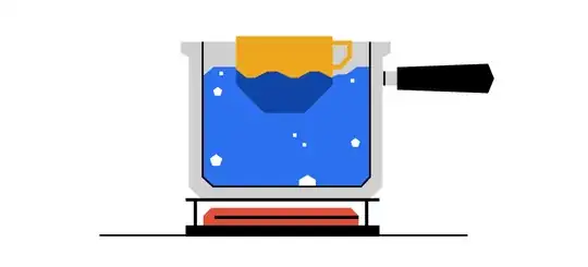

A cup of warm water is suspended in a large pot of water held at a steady boil. Will the water in the cup ever boil? Assume that the pot never runs out of water.enter image description here

The illustration here is enlightening. The vapor bubbles form at the bottom of the pot, where the temperature of the heat source exceeds 100°C, as is required in practice for boiling*. As they float to the top of the water, they condense somewhat, indicating that the water is at 100°C or cooler. This water is thus not capable of making the water in the cup boil.
*A summary of the linked discussion: the formation of a vapor bubble costs energy beyond the latent heat, as we also need to create a new gas–liquid interface. Surfaces cost energy because the bonds are comparatively unsatisfied relative to the bulk. Consequently, some degree of overheating is always required for boiling, even in the heterogeneous nucleation case.

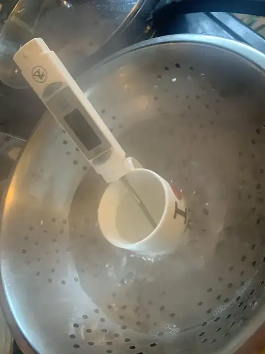

I don't have the rep to add to the above answer. But FYI I did attempt this experiment IRL and can say that the temp in the cup never got much above 90 deg C. I did leave it at a rolling boil for 10 mins even. I also tried with a lid over top, I could not get the water in the cup to boil that way either. It was not possible to fit the thermometer under the lid.
pic of experiment
