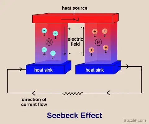

enter image description here Taken from: https://sciencestruck.com/seebeck-effect-with-applications
In the diagram above, you can see that heat does not actually travel between junction materials. Heat does not flow from junction material A to junction material B resulting in A being colder than B.
Instead, each individual junction material sits in a temperature gradient. In other words, A has a different temperature on each end, and B also has a different temperature on each end. It's not the temperature difference between junction materials that matters. It's the temperature difference within the same junction material.
So that was the Seebeck effect where you apply a temperature gradient to produce current. The Peltier effect is just in reverse. So you apply current to produce a temperature gradient.
Therefore, since your electrically conductive, thermally conductive material still allows current to flow between junction materials, and since the temperature gradient is within each junction metal rather than between junction metals, the thermal insulation does nothing and the system still works like normal.
