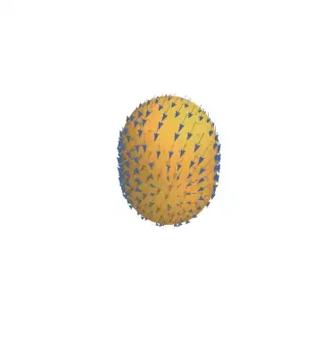

A dipole rotating in the $xy$ plane as described in the question is given by $\boldsymbol{d_0} = \frac{1}{\sqrt{2}}(\hat{x}+i\hat{y})$.
Plotting the real part of this vector field on a surface of constant amplitude gives:
We can see that light propagating upwards along the $z$ axis is right hand circularly polarized, light traveling downwards is left hand circularly polarized and light propagating horizontally is linearly polarized in the $xy$ plane. Of note is that the light propagating in the $x$ direction is $\pi/2$ out of phase with light propagating in the $y$ direction. This gives the field the sense of rotation at all locations.
In the vertical direction the light has angular momentum due to the rotation of the polarization vector. This is spin angular momentum. In the horizontal direction the light has angular momentum due to the global rotating structure of the field. This is orbital angular momentum.
