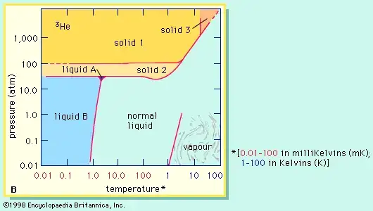

helium-3 phase diagram
[source]
Here's a phase diagram for helium-3 that shows both the pressure and the temperature on logarithmic scales, going down to $\rm10\,\mu K$. (Dear Britannica-from-twenty-years-ago: using a different colored font to represent a unit change is bad design.) For helium-4 the diagram is similar, but the temperatures and pressures of the phase transitions are different: helium-4 and helium-3 have very different masses. The number of distinct phases for helium-4 versus helium-3 is also different, because helium-3 has a different nuclear spin than helium-4 and therefore different statistical properties. There are a number of features on this diagram that we hide from students who are new to thermodynamics, like the critical point on the curve between the normal liquid and the vapor phase.
You can see from this diagram that helium (or at least helium-3) does have a low-temperature solid phase, but not at one atmosphere of pressure. Furthermore, the minimum pressure to support the solid phase appears to be temperature-independent, even at the little triangle of superfluid-A phase. I bet there's an interesting explanation about why the solidification pressure doesn't depend on temperature, but I don't know it.
