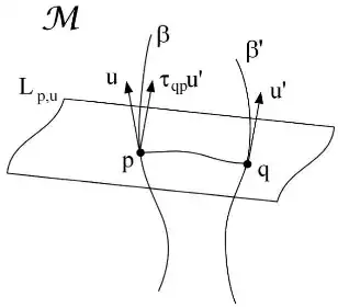

In order to generalize $(1)$ to situations where observers are located at different spacetime points we need a framework which allows us to select a pair of points $p$ and $q$ at each of observers' worldlines. One way to do that is using the concept of Landau submanifold a.k.a. Fermi surface: by picking a point $p$ with 4-velocity $u$ at the first observer worldline we exponentiate the orthogonal space $u^{\bot}$ of $u$ from $T_p \mathcal{M}$ onto spacetime manifold $\mathcal{M}$. The resulting Landau submanifold $L_{p,u}$ is intersected by the worldline of the second observer at a point $q$ representing the simultaneous to $p$ event of the second observer history. There is a unique geodesic connecting $q$ and $p$ allowing us to parallel transport along it the 4-velocity $u^′$ of the second observer from $T_q\mathcal{M}$ to $T_p\mathcal{M}$ obtaining $\tau_{qp} u^′$ (here $\tau$ denotes parallel transport operator). This is illustrated by the image taken from the paper:
Image from Bolós' paper
We could then use $\tau_{qp} u^′$ instead of $u^′ $ in $(1)$ and obtain what is called kinematic relative velocity of $u^′$ with respect to $u$: $$ v_\text{kin}:=-\frac{1}{g(\tau_{qp} u^′,u)} \tau_{qp} u^′ - u. $$

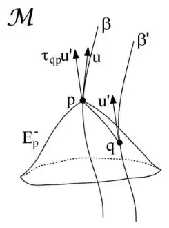

As already mentioned this is not the only possible choice for the relative velocity. Instead of Landau submanifold $L_{p,u}$ we could use the horismos submanifold of $p$ $E^{-}_p$ by exponentiating past lightcone of $T_p\mathcal{M}$ to obtain the intersection point $q$ of the send observer's worldline (see figure):
Another illustration from Bolós
This would give us the spectroscopic relative velocity, more useful in observational cosmology.

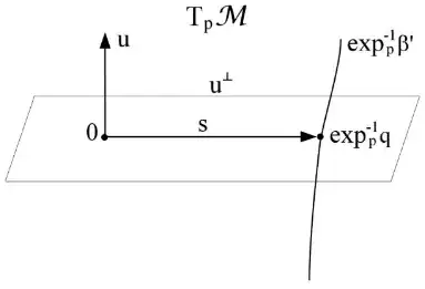

Yet another alternative instead of parallel transport of 4-velocity is to use the variation of relative position.
Given observer ar $p$ with 4-velocity $u$ and simultaneous event $q\in L_{p,u}$ relative position $s$ is defined as $s:=\exp^{-1}_p q$ (see figure):
definition of relative position
Projection of variation of relative position $\nabla _u s$ onto $u^{\bot}$ gives us the concept of Fermi relative velocity : $$v_\text{Fermi}:=∇_us+g(∇_us,u)u.$$
