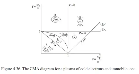

The CMA (Clemmow - Mullaly - Allis) diagram for a plasma of electrons and immobile ions is shown below:
Source: Gurnett & Bhattacharjee, Introduction to Plasma Physics with Space, Laboratory and Astrophysical applications page 133
While in some sense I understand the diagram where the topological shapes show how the $R$ and $L$ modes (right polarized and left polarized modes), corresponding to wave propagation at an angle $\theta = 0$ to the magnetic field, transit to the $O$ and $X$ modes (ordinary and extraordinary modes), when $\theta$ changes from $0$ to $\frac{\pi}{2}$
Earlier in the book, on page 129, it is stated that the combinations of the topological shape for each transition is purely determined by the value of the refractive index $n$ at $\theta = 0$ and $\theta = \frac{\pi}{2}$. Basically, notice that in each region we have two topological shapes, such as 2 ellipsoids in the bottom left triangle. This corresponds to the two modes $R$ and $L$ and how they transit as $\theta$ changes from $0$ to $\frac{\pi}{2}$
For example, if we look at the topological shape at the bottom left triangle near the origin, bounded by the $R = 0$ line and the axes, I understand that the ellipsoid means that the refractive index does not change sign when transiting from $\theta = 0$ to $\theta = \frac{\pi}{2}$ for BOTH the $R$ and $L$ modes.
What I don't understand is:
(a) In order to draw the topological shapes, we need to know whether the refractive index $n$ changes sign. How do we determine this from the CMA diagram?
(b) In some cases, the $R$ mode transits to the $X$ mode while in others, the $R$ mode transits to the $O$ mode. How can we tell whether the $R$ mode transits to the $O$ or the $X$ mode? How do we know is not possible that both the $R$ and $L$ mode transits to $X$?

Clemmow-Mullaly-Allis (CMA) Diagrams
CMA diagrams are typically labeled in the following way. Each line/contour has two labels, the polarization at wave normal angle of zero degrees and the mode of propagation at ninety degrees. The $R$, $L$, $S$, and $P$ terms change sign at the bounding surfaces defined by $R = 0$, $L = 0$, $S = 0$, $P = 0$, $R = \infty$, and $L = \infty$.
Closed contours indicate a continuous index of refraction – index of refraction remains real and is continuous in its change across a boundary. Open contours indicate a change to an imaginary index of refraction. Since this is a cold plasma approximation, the only option of imaginary indices of refraction is evanescence since the waves cannot transfer energy to the particles directly.
