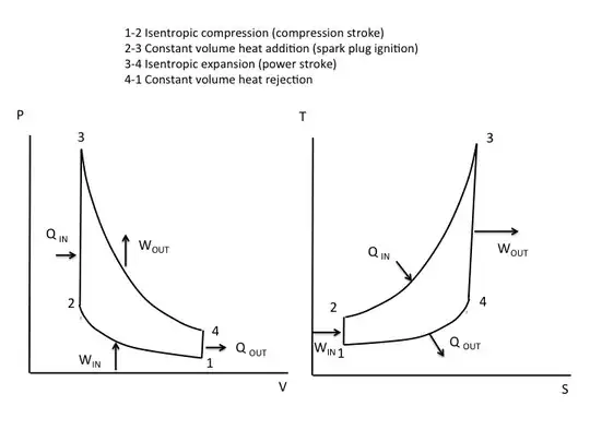

All real cycles, including the Otto, are irreversible. The main reason is all real cycle are not composed of quasi-static processes, meaning not composed of processes that are carried out so slowly as to appear to be static (not moving), which would make them impractical.
That said, the internal combustion engine Otto Cycle can be modeled as a reversible cycle as shown in the PV and TS diagrams below. (Note: intake and exhaust strokes not shown).
The heat addition (spark ignition) process 2-3 is modeled as a constant volume (isochoric) reversible heat addition. In a real Otto cycle the ignition results in a rapid increase in temperature and pressure from 2 to 3. A rapid increase is by definition non quasi-static and therefore irreversible.
In the reversible cycle below the heat addition is provided by an infinite series of thermal reservoirs ranging from T2 to T3, each reservoir infinitesimally greater than the previous. This results in a very slow, quasi-static transfer of heat making the process reversible.
The problem with the reversible cycle is it has to occur so slowly that it would be impractical. If you put a reversible Otto engine in your car you would get phenomenal fuel economy, but you would move so slowly that pedestrians would be passing you by!
Hope this helps.
