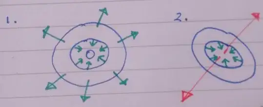

In diagram 1. A dense region of matter (blue circles), is resisting collapse due to pressure (green arrows). The pressure is positive at the outside circle but at the middle circle, since the pressure is acting inwards and outwards, some inward pressure arrows have been put on.
Diagram 2. The region of matter inside the inner circle of diagram 1. has now escaped, due to the high pressure and possibly some asymmetry or disturbance such as might occur if a star collided with a galactic nucleus. The red arrows show the direction of the escaping matter.
Now we are left with the green arrows on diagram 2 i.e. negative pressure and less outward positive pressure at that circle. According to formula 1) the active gravitational mass of matter within that circle is reduced, but there is still the high pressure that would speed up the matter, which would then be ejected also in the direction of the red arrows.
So in this way could a negative pressure - positive feedback cycle occur in a galactic nucleus? When enough matter has been ejected, the pressure would become negligible and the situation would then revert to the usual situation, where positive pressure is resisting the gravitational collapse.

There seems to be confusion about pressure here. The diagrams portray pressure as a vector, but it is a component of a second-order tensor -- or in the case of isotropic fluids, simply a scalar, as you are denoting $p$. There is no distinction between "outward" and "inward" pressure; they are the same thing.
Moreover, all familiar forms of matter, including massive particles as well as massless ones (radiation), have nonnegative pressure. (The main exception is "dark energy".)
The removal of matter from a region of space, leaving vacuum, results in zero pressure there, not negative pressure. Likewise, matter that is adjacent to vacuum develops lower pressure as a result, but not negative pressure.
To be clear: Vacuum doesn't suck (well, except perhaps a tiny amount due to cosmological dark energy). The intuition that it does is based on Earth conditions where the baseline is ambient atmospheric pressure. But the $p$ in the gravitational formulas is absolute pressure.
