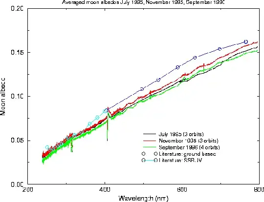

Moonlight is quite reddened compared to Sunlight. The lunar albedo is roughly 0.07 at 400 nm and double that or 0.14 at 700 nm.
It doesn't look terribly red because our blue and red receptors aren't pinned at those extremes, but for any given plant you would have to look at the specific receptor molecules at play and what their sensitivities are. See for example Are two colors (red + blue) necessary for LED grow lights, or would either color be sufficient? in Biology SE and some of the plots there.
From this answer to Why doesn't a full/gibbous moon high in the sky ever seem to look orange? Shouldn't it? and also this answer to Why is this moon red?
above: "Figure 8: Averaged geometrical moon albedos measured by GOME from July 1995, November 1995, and September 1996." From ESA's GOME moon measurements, including instrument characterisation and moon albedo. below: From this answer and obviously the EPIC camera of the DSCOVR satellite; one of the famous "Moon photobombs Earth" photos.

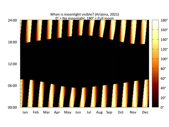

Just for fun, here's a plot of moonlight visibility in Arizona in 2021:
