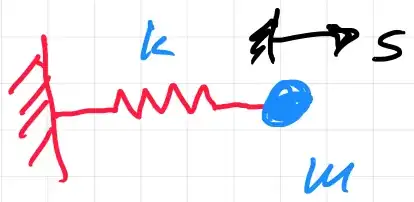

Lets look at this simple example
with:
$$a=\frac{dv}{dt}~,v=\frac{ds}{dt}\\F=-k\,s$$
you obtain the equation of motion
I) $~m\,a=F$
$$m\,\ddot s+k\,s=0$$ and with $s(0)=s_0~,\dot{s}(0)=0$
$$s \left( t \right) =s_{{0}}\cos \left( {\frac {\sqrt {k}t}{\sqrt {m}}} \right) $$
II) $~m\,v\,s=F$
$$m\,\dot s \,s+k\,s=0$$ thus with $~s(0)=s_0$
$$s \left( t \right) =-{\frac {kt}{m}}+s_{{0}}$$
but this result is not what we expecting form the physic, so the second ansatz is wrong and Newton ansatz is the correct one.
