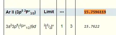

I know this sounds dumb, but it puzzles me when I search for ArI levels catalogue in NIST. It shows argon's first ionisation level as $15.7596119 \; \text{eV}$ in row 427, with more rows after with energy above that. This is puzzling. How can atomic energy levels go beyond ionisation level? Shouldn't the atom be stripped off an electron and becoming an ion on those levels? NIST documentation put some words on this, but it doesn't explain the question I want to know. Chances are that this is an idiotic question out of poor knowledge, please forgive my ignorance if that's true.

If you look at the entries in the NIST document around the ionisation energy:
Ionisation energy
then $15.7596119$ eV is the energy needed to ionise the atom and leave the ion in the ${}^2P^\circ{}_{3/2}$ state. The higher energy $15.7622$ eV is the energy needed to excite an electron to the 9d level and also excite the whole atom to the ${}^2P^\circ{}_{1/2}$ state.
