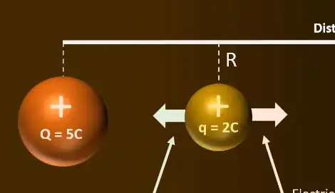

  2. I don't quite understand how this model is applied in a 9V battery for instance. All the videos I watched are showing this big floating somewhere in space, and then talk about the little q pushed towards the big Q
how does this model fit in a battery (or any other DC power supply)? What is the source of the electric field? And - as far as I understand - voltage is the mere difference in electric potential between two points. So if we take every two points in the field we can calculate the Voltage between them. But if we won't place any charges there, there won't be any current. But with batteries - we say that the mere presence of voltage meaning that there'll be current flowing if we close the circuit.

Note that gravitational and electric potential energy is very comparable, even in their reverse proportionalities to distance:
$$U_g=G\frac{mM}{r}\qquad\qquad U_e=k\frac{qQ}{r}.$$
