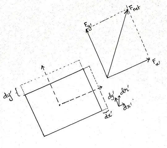

Imagine a vector as you know it. Sticking with stress example, say it is the restoring force inside a rubber band.
So if we displace the object along a direction $\hat r$ by a magnitude $dr$, the force developed is given by: $$\vec F = k \times d\vec r$$
Here $k$ is a scalar as it scales the vector $d\vec r$ to a new magnitude. Note multiplying by a scalar cannot change the direction.
But now imagine instead of a rubber band we have a rubber sheet. And lets say (important) the sheet is such that it is easier to stretch along one direction and harder along the other. let's call this directions $\hat{x'}$ and $\hat{y'}$. And let the proportionality constant $k$ along each direction be $k_1$ and $k_2$. So if we wanted to find the restoring force developed inside the sheet given we stretched the sheet in some random direction $d\vec r$,
We will resolve our displacement vector $d\vec r$ along $\hat{x'}$ and $\hat{y'}$ as :
$d\vec r = dx'\hat{x'} + dy'\hat{y'}$
Now the restoring forces for each of this component displacements are :
$F_{x'} = k_1 dx'$ along $\hat{x'}$
$F_{y'} = k_2 dy'$ along $\hat{y'}$
So net restoring force developed is : $$\vec F = k_1 dx' \ \mathbf{\hat{x'}}+ k_2 dy' \ \mathbf{\hat{y'}}$$
Notice that this cannot be written as $\vec F = k d\vec r$ for some scalar $k$. That means $F$ is not in the same direction as $dr$. So a scalar cannot describe how force and displacement are related.
But we can write the relation as : $$\pmatrix{F_{x'} \\ F_{y'} } = \pmatrix{k_1 & 0 \\ 0 & k_2} \pmatrix{dx' \\ dy' }$$
This 2x2 matrix that is neither a scalar nor a vector is the thing you are in search for. It is something that not only scales a vector but also changes its direction. This is the stress tensor which basically is a matrix.
The same happens in many cases... Electric polarisation, Moment of inertia etc also are not just scalars but matrices. This is because Some substances have different Polarisations along, different moments of inertia etc along different directions.
Now in this case, I had my coordinate axes along the two special directions $\hat{x'}$ and $\hat{y'}$. But if our axes are not so, the off diagonal elements of $\mathbf k$ matrix will also be non-zero. And if our sheet has edges not perpendicular to the direction of force, we may have to resolve the forces along the normal vectors as well... So the matrix gets more and more complex but I hope I conveyed how something can be neither a scalar nor a vector.
