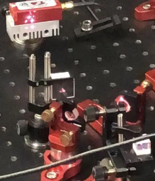

We use a 780 nm laser in our lab, and that makes it in the near infrared (IR) range. The majority of people can not see this wavelength of light. However, when the beam reflects off of an object (see image), the light becomes visible. This image has been taken with an iPhone camera which has a poor (or non existent) IR filter, though the light is visible with the eye.
Some questions have been asked which are related. The answer to one of them suggests that when an object is stationary, the reflected beam should lose energy. So why is the reflected beam experiencing an increase in energy here?

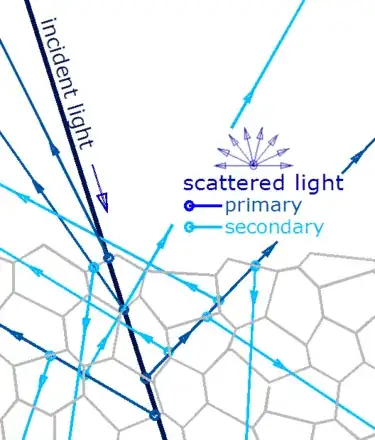

You can never see any light beam from the side. You only see light (of whatever wavelength) propagating directly into your eye. When laser beams sometimes appear as a visible line through the air, what is happening is that dust (and to some extent molecules too) in the air are scattering the light, sending some of it towards your eye. When the beam hits a solid object, then unless the surface is extremely flat (such as a precise and clean mirror) there will be scattering at all angles, so some will go towards your eye. It is this light which you are seeing.
In the case of infra-red radiation, the human eye sensitivity does not drop off immediately for wavelengths above 700 nm; it is low but non-zero, and the scattered radiation from a laser beam is often bright enough to be seen (obviously it depends on the intensity of the original beam). I have in this way seen 852 nm, for example. However, when you can see a wavelength such as this, you should take care: the radiation entering your eye is brighter than you may think, because your eye's sensitivity is low but you are seeing it. Eye protection is for this reason especially important with wavelengths outside the normal visible range.

I am sure that no conversion of photon energy is happening here.
Especially you need an up-conversion in energy which is very unlikely. Normal flourescence cannot be the cause here. There are detector cards for up-conversion of laser light, but they need to be "charged" by sunlight before they can be used . And this is very special material.
More likely the laser is relatively strong and the sensitivity of the eye is still sufficiently high.
For example: While I was working with 762 nm laser (Oxygen A-band) I, and all my colleagues, were able to clearly see the beam (even though 762 nm is already classified as IR). The laser had a power of ~ 300 µW and the collimated beam was clearly visible on a sheet of white paper at daylight conditions. When spread over 1 cm area the beam was very visible with light of.
Even though 780 nm is certainly further in the IR than 760 nm, your laser might be more powerful and the eye is still able to see the beam.

Diffuse reflection is the reflection of light or other waves or particles from a surface such that a ray incident on the surface is scattered at many angles rather than at just one angle as in the case of specular reflection. But the above scheme continues to be valid in the case that the material is absorbent. In this case, diffused rays will lose some wavelengths during their walk in the material, and will emerge colored.
