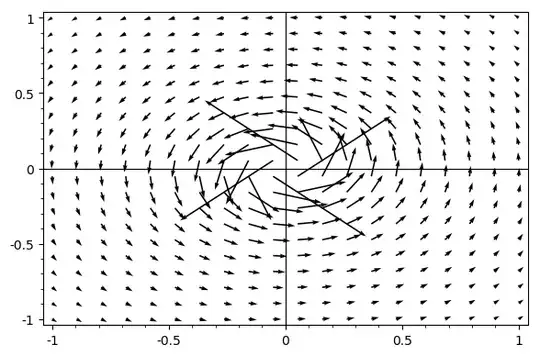

If I plot this field (shown in x-y Plane), it looks obvious that it should have curl; since the magnitude of the field lines increase approaching the center, any point in this graph should "spin" clockwise. I realize that this is an intuitive definition of curl, so please correct me if I'm wrong for using it. enter image description here
