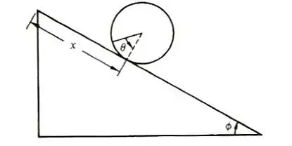

Here is an example about the constraint problem: enter image description here
If the rolling body has a constraint of no-slip condition (x=Rtheta), friction is applied on the x and theta coordinate. Then we can say the generalized coordinate of x and theta is not conserved. theta is not explicit about L, but can we say theta is cyclic?
Well, as the system has a holonomic constraint(no-slip) the system has no coordinates which the corresponding generalized momentum is conserved. Therefore I was wondering:
enter image description here even if the generalized momentum is not conserved, can the coordinate be cyclic? What if we, suppose change the Lagrangian in a form like: enter image description here It's basically the same Lagrangian except the holonomic constaint is applied. Can we still say the coordinate theta be cyclic?

Case I
you have two degrees of freedom $~x~,\theta$
the Lagrange function is:
$$\mathcal{L}=\frac{m}{2}\,\dot{x}^2+\frac{I}{2}\dot{\theta}^2+m\,g\,\sin(\phi)\,x-(x-r\,\theta)\,\lambda\tag {1}$$
the last term is added because you are not working with generalized coordinate, hence you have to add the rolling condition $~x-r\,\theta~$ and the generalized constraint force $\lambda$
$\Rightarrow~$
$$\frac{\partial\mathcal{L}}{\partial \theta}=r\,\lambda\ne 0$$ $$\frac{\partial\mathcal{L}}{\partial x}=m\,g\,\sin(\phi)-\lambda\ne 0$$
Case II
from the rolling condition you can obtain $~x=r\,\theta~,\Rightarrow\,\dot x=r\,\dot\theta$ so $~\theta$ is now generalized coordinate.
from equation (1)
$$\mathcal{L}=\frac 12\,m{{r\,\dot\theta}}^{2}+\frac 12\,I{\,\dot\theta }^{2}+mg\sin \left( \phi \right) r \theta $$
$\Rightarrow~$
$$\frac{\partial\mathcal{L}}{\partial \theta}=m\,g\,\sin(\phi)\,r\ne 0$$
thus either $x$ nor $\theta$ are cyclic coordinates
