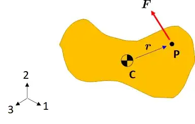

I'd like to start by stating the no the torque vector is not the rotational equivalent of a force. More specifically, we are talking about the moment of a force here.
fig1
Next, consider a coordinate system that really describes a set of useful directions. I have named them 1,2,3 above.
Just as a location vector $\boldsymbol{r} = \pmatrix{r_1 \\ r_2 \\ r_3}$ can be expressed as 3 components along the coordinate system directions, so is a force vector $\boldsymbol{F} = \pmatrix{F_1 \\ F_2 \\ F_3}$.
This literally means how much of each quantity is along each direction.
The to calculate the moment of the force $\boldsymbol{F}$ you do the following
$$ \boldsymbol{M} = \boldsymbol{r} \times \boldsymbol{F} = \pmatrix{ r_2 F_3 - r_3 F_2 \\ r_3 F_1 - r_1 F_3 \\ r_1 F_2 - r_2 F_1} $$
It too has three components along the coordinate system.
I have also a more length post on the nature of the cross product in relation to moment-of type of quantities.
One last item I must say about forces is that they reside along a line of action. You can slide the force vector along this line of action and it will not change the nature of the problem (for rigid body mechanics problems). The line of action is defined by the direction of the force vector and any point that the force might go through.
Now depending on the nature of the force (if it is external, or body riding) the direction of the force vector might change with time.
Gravity, for example, is along a constant direction only near the earth and can change directions when considering space applications. So is the force from a thruster as it follows the pose of the body.
