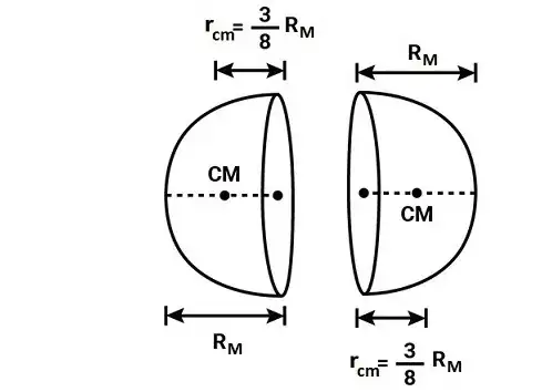

They certainly will join together if the distance between the halves (hemispheres) is not too large. In order to prove this, first we have to compute the gravitational force between two halves and then evaluate the time needed for reconnecting. And, the tidal forces do not play a crucial role here unless the distance is large (see a justification in the appendix).
This problem is an interesting exercise in Classical Mechanics course and it can be computed using the Poisson's equation for gravity. For example, in this article, different cases are explicitly calculated. However, there is an easy, more intuitively way to approximately calculate the gravitational attraction between hemispherical masses. So, the discussion here is simplified in my answer to provide a good estimation.
Suppose we divide the Moon (with the radius $R_{\rm{M}}=1737.4 \,{\rm{km}} \simeq 1.74 \times 10^{6} \, \rm{m}$ and the mass $M_\rm{Moon}=7.342 \times 10^{22}$ $\rm{kg}$) into two halves and the distance between these halves is small, e.g., $1$ $\rm{meter}$ (after reading this answer, you can even try $1$ $\rm{km}$). For each hemisphere, we have to find the center of mass point, the point to which the total gravitational force is applied (see WikiPedia about center of mass). For a hemisphere the location of center of mass1 is computed as ${r_\rm{cm}} = \frac{3}{8}{R_\rm{M}}$. See the following figure.
The distance between the hemisphere (center of) masses is $\Delta r = {r_c} + {r_c} = \frac{3}{4}{R_M}$ (the distance between them is too small in comparison with the radius of Moon). Now, the gravitational force between two hemispheres can be obtained by use of the Newton's gravitational law as
$$\begin{array}{l} F = G\frac{{{m_1}{m_2}}}{{{\Delta r^2}}}\\ \,\,\,\,\,\, = G\frac{{\left( {\frac{{{M_{{\rm{Moon}}}}}}{2}} \right)\left( {\frac{{{M_{{\rm{Moon}}}}}}{2}} \right)}}{{{{\left( {\frac{3}{4}{R_{\rm{M}}}} \right)}^2}}}\\ \,\,\,\,\,\, = \frac{4}{9}G\frac{{M_{{\rm{Moon}}}^2}}{{R_{\rm{M}}^2}} = 5.3 \times {10^{22}}\,{\rm{N}}, \end{array}$$ which is large enough to easily pull the halves towards each other ($G =$ gravitational constant).
The acceleration of one half to the other can also be obtained from Newton's second law, yielding
$$a = \frac{F}{{\left( {\frac{M_\rm{Moon}}{2}} \right)}} \simeq 1.45\frac{{\rm{m}}}{{{{\rm{s}}^{\rm{2}}}}},$$
and compare this to the surface gravity of the Moon, $\sim 1.62$ $\rm{m}/\rm{s²}$.
Finally, assuming that the acceleration is constant during fusion (which indeed is a good approximation since the distance between the halves is small), the net time it takes for the halves to come together is simply obtained from the following equation
$$y = \frac{1}{2}a{t^2}\, \to \,t = \sqrt {\frac{{2y}}{a}} \simeq 1.18 \, {\rm{s}}.$$
So, according to this simple discussion, the hemisphere masses at a distance of one meter from each other will collide with each other quickly, a little over a second. If you take the distance between the two hemispheres to be one centimeter, you will obtain $0.118$ $\rm{s}$. Of course, the shorter the distance, the much less severe the collision.
Finally, it should be emphasized that, because of the Moon's spin, the time it takes for the halves to come together increases (and some new details should be considered). However, the Moon's spin is small since it also takes approximately $27$ days for the Moon to rotate once on its axis. But, simply assuming that the two halves are very close to each other, the problem of the Moon's spin can be ignored with a very good approximation.
