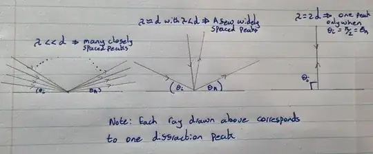

If $\lambda_{x}\ll d_\mathrm{atomic}$, according to Bragg's law, there will be many closely spaced diffraction peaks which will occur at virtually all angles of incidence. As I increase the wavelength so that $\lambda_x$ approaches $d_\mathrm{atomic}$, there will be fewer and fewer diffraction peaks so that reflection will only be observed to occur at a few widely separated angles of incidence. Eventually, when $\lambda_x=2d_\mathrm{atomic}$, we will only have one diffraction peak at $\theta_i =\pi/2$ so that reflection is only observed when the incident x-ray wave vector is perpendicular to to crystal surface. This behaviour is summarized in the image below:

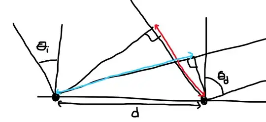

In reflection geometry, these additional peaks follow Bragg's law in the form $$ d\sin(\theta_\mathrm{i}) = d\sin(\theta_{\mathrm{d},n})+n\lambda, \tag{$*$} $$ where $d$ is the interatomic spacing at the surface, $\theta_\mathrm{i}$ is the incidence angle and $\theta_{\mathrm{d},n}$ is the diffraction angle (both measured from the surface normal), and $n$ is the order of the diffraction (which can be positive, negative, or zero). This corresponds to the following geometry
and it imposes the requirement that the red and the blue lengths differ by an integer number of wavelengths. It's important to note that this is different from the usual geometry drawn in textbooks, where the constructive interference comes from various planes inside the material $-$ here the constructive interference comes from scattering at the different atoms at the surface (though also deeper inside) with the crystal spacing between them parallel to the surface itself.

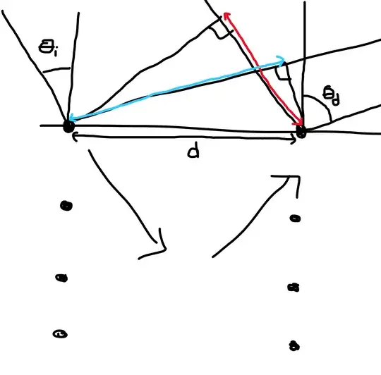

That said, it is important to note that this covers the surface layer of the crystal, and that you get similar reflections from each of the crystal planes that lie underneath. As regards Bragg reflections in the transverse crystal planes (described by $(*)$), each of those crystal planes will have identical dynamics to those described above.
However, there is an additional effect that comes in when you consider the reflections deeper into the crystal: in addition to the transverse interference I described above, you can also have constructive (or destructive) interference between waves that scatter at different crystal planes at different depths.
Here things get a bit more tricky in that this interference can affect the intensity of the reflected and diffracted beams, and it can potentially reduce them substantially. And, of course, it can also add new types of diffracted beams. However, to describe those things effectively, you really need to develop the full-blown theory of scattering from a periodic 3D lattice; this is explained in depth in any reasonable condensed-matter textbook.
The upshot is that it is perfectly possible to have certain combinations of incident angle and wavelength where the Snell-like zero-order reflected beam is much stronger, as well as where it is substantially or even totally suppressed, coming from the interference of reflections off of the various sub-surface crystal planes.
