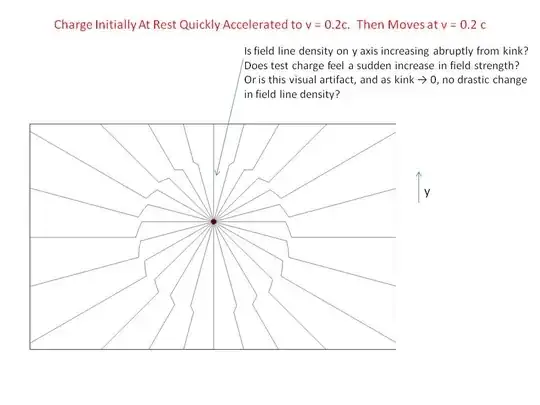

Purcell's text and online simulations of the field lines of accelerating charged particles show a circular kink in the field emanating from a moving charged particle when the charged particle accelerates. I have attached a screen capture from an online simulation where I had an initial stationary charge accelerate briefly to 0.2 c in the upwards direction, and then continue to move at that speed. It seems that the kink diminishes to 0 along the axis of motion. This seems to be consistent with the behavior of dipole antennas that don't emit radiation along the axis of the dipole.
However the diagram also seems to show that on the +y axis, there is a sudden narrowing / widening of the field lines. Is this sudden narrowing/widening just a visual artifact of the lack of field lines very near the axis?
Even if this is just a visual artifact, there is still the gradual narrowing of field lines corresponding to an increase in field strength that occurs as the charged particle moves upwards at constant speed. To a test charge on the y axis that is being approached by the moving charged particle below, the electric field must be increasing as it gets closer, and my intuition is that the charged particle's movement parameters (distance, velocity >0, acceleration = 0) can't be transmitted faster than the speed of light. Yet if there is no radiation along the y axis, how is the test particle detecting the current position and state of motion of the charge?
Is the answer connected to the fact that in a reference frame moving upwards along with the charged particle so that it appears stationary, then it is the test charge that is moving? In this frame, the charged particle is stationary and could have had an arbitrarily long time to suffuse space with its field before the test particle came moving along? enter image description here
