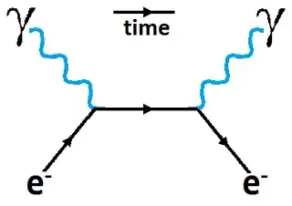

At the level of particle physics interactions, the concept of force is relevant as momentum transfer, dp/dt. All Feynman diagrams that describe the mathematics of the interactions transfer a dp/dt at the vertices the momentum carried by the intermediary particles. Take the simple Compton scattering:
compt
the force is carried by the virtual electron, from the incoming real particles to the outgoing real particles.
