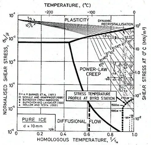

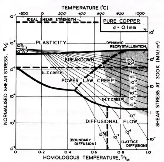

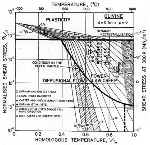

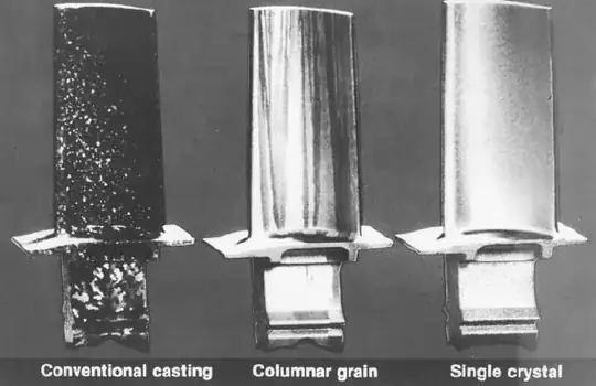

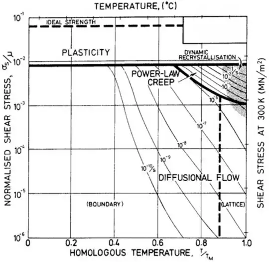

Creep is frequently characterized using a deformation mechanism map, which identifies which creep mechanism (e.g., viscous flow, dislocation creep) predominates under the specific temperature and applied stress and displays the predicted strain rate (e.g., $10^{-10}\,\mathrm{s}^{-1}$, with approximately evenly spaced lines reading $10^{-5}$, $10^{-6}$, $10^{-7}$, and so on indicating an exponential rate decrease with decreasing temperature):
Copper, ice, and olivine are shown together here to emphasize the commonality of creep in material types that aren't often grouped together. Creep is universal.
The following generic form is typical:
In these maps, we find various regimes marked power-law creep in addition to boundary and lattice diffusional creep. Now, it's a common outcome when comparing various kinetic processes that because of the exponential dependence of rate on the activation energy, we see an interplay of predominance between processes with higher or lower reactant concentrations and higher or lower activation energies. Here's what I mean:
  1. The regime of grain boundary and surface diffusion typically dominates at lower temperatures and lower stresses because the bonding at interfaces is poor and allows more mobility, corresponding to a lower activation energy for physical rearrangement. This is the regime in which engineering materials are typically implemented; the creep rate is generally negligible when considering the lifetime of the system, structure, device, or object. However, when you hear about turbine blades being grown as single crystals at great effort and expense, it's to eliminate problematic grain boundary creep:
F. L. VerSnyder and E. R. Thompson, Alloys for the 80’s, R. Q. Barr, Ed., Climax Molybdenum Co., 1980, p. 69, reprinted in Hertzberg's Deformation and Fracture Mechanics.
  1. At higher temperatures, lattice or bulk diffusion (i.e., diffusion within the host material) often dominates because there are many more atoms in the bulk than along interfaces. In other words, these bulk atoms are better bonded and less likely to flow than interface atoms, but there are so many of them that sufficient thermal activation causes their effect to add up. Now, I realize your question focuses on metals, but I'll add that in polymers, long molecular chains may slide past each other at an appreciable rate given that the glass transition temperature or melting temperature may not be much higher than room temperature. Consider the creep of PVC resin at 20°C (i.e., room temperature), showing that creep in engineering materials doesn't require searing temperatures or geological time scales:
  1. Larger stresses tilt the energy landscape such that the effective barriers to dislocation movement are lowered. In this way, dislocations are driven to carry plasticity through the material via a combination of glide and climb (power-law creep, so named because the rate increases exponentially with increasing stress). At a certain stress in certain materials, dislocations glide easily and nearly instantaneously; we call this stress the yield strength and in engineering contexts often ignore the nuance of slow creep in favor of a yield–no yield dichotomy. In other words, we replace the fanning out of lines representing strain rates of, say, $1\,\mathrm{s}^{-1}$ (representing a fast rate) to, say, $10^{-10}\,\mathrm{s}^{-1}$ (representing a slow rate) with a single horizontal line called the yield strength.
It's important to note that regardless of which mechanism dominates under a certain set of conditions, all valid creep mechanisms for a particular material are acting all the time, although the rate may be minuscule.

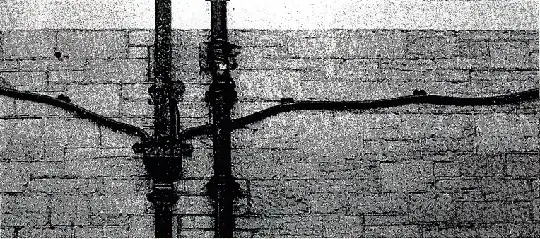

Finally, a classic example of noticeable creep is the sagging of lead pipes over decades:
Given enough time, this sagging arc will accentuate and fail by material pinching off, in the manner of any viscous fluid. Lead's low melting temperature means that room temperature corresponds to a quite-high homologous temperature, so prominent creep observations of a familiar metal become accessible over a human lifespan. Make no mistake, however: the pipes could be made of any other material, and such sagging would simply be a matter of time. In the long term, elasticity is an idealization, albeit a very reliable one for many metals and ceramics (and some polymers) at familiar temperatures and over familiar time scales. Many of the other existing answers appear to rely on this idealization, but it sounds like you're asking about the nuances of the very long term. This answer is intended to address one such nuance.

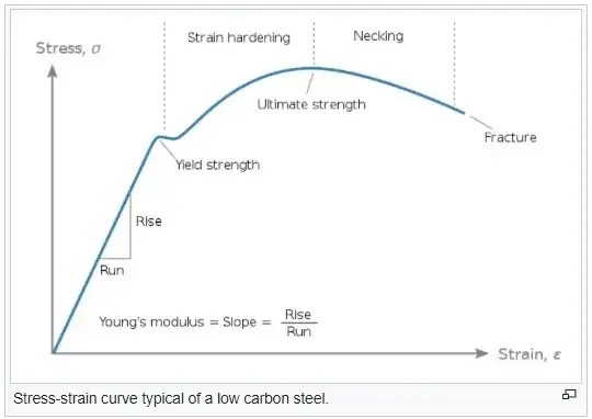

The stress-strain curve of a fairly typical metal looks like this:
Stress strain curve
If stress is applied to a bar in such a way that the stress value remains in the linear (aka elastic) part of the $(\sigma,\varepsilon)$ curve, an equilibrium of forces arises with no movement. It doesn't matter how long this state of affairs persists: the bar will not move or break.
But if the stress exceeds the yield strength, then the bar will be further extended in accordance with the $(\sigma,\varepsilon)$ curve.

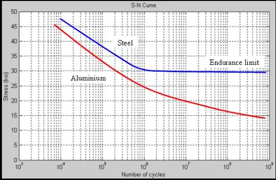

This behaviour can be determined from what is known as an "S-N" curve.
I wanted to provide an engineering alternative to the creep answer, which is technically correct over very long time scales and accurately describes the mechanism of failure. Depending on your rod's material, cross-section, and applied force, there may be a stress range such that the "Factor of Safety for Infinite Life" is 1 or greater.
For example, here are S-N curves for steel and Aluminum:
S-N Chart for Fatigue Limit from Wikipedia
These curves are determined experimentally, and typically represent a linear-fit 3 standard deviations below a line drawn through the stress-range and number of cycles to failure for numerous specimens. This means the conclusions that can be drawn from such curves are empirical, which may not be satisfactory for your thought experiment.
For steel, there is a theoretical stress range below which your structure will have "infinite life", as demonstrated by the levelling out of the S-N curve as the number of cycles increases (Theoretically the creep-induced defects may still accumulate, and eventually cause failure, I'm not intimately familiar with the testing used to derive these curves). However, for other materials, such as aluminum as shown in the same chart, no such leveling occurs, and the material has no stress range for which infinite fatigue life is possible (always a comforting thought in old airplanes).
Note that the stress range for infinite life as presented in this chart is about 30 KSI, which is below the yield point of steel at about 36 KSI. In practice, when you have to account for defects and stress-raisers associated with structural configuration and welded connections, the actual allowable stress range drops quite rapidly. A more typical allowable stress range for a realistic welded structure with a reasonable fatigue performance (20 years or so) is on the order of 7.3 KSI, or 50 N/mm^2.
