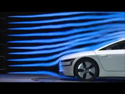

You're right that the butterfly wasn't skilfully avoiding the car. It didn't need to because it was carried over your car by the air flowing around the car. If you look at the image below of the streamline pattern around a car, we see that the streamlines start to bend upwards before they reach the front of the car. If the butterfly was at the level of your windscreen a few metres in front of your car, it would happily be carried up and over your car by the airflow.
The exception would be if the butterfly was about the height of your front bumper. We can see from the streamline pattern that there must be a stagnation point here, in which case the butterfly would end up splatted. It might also not have a fun time being carried under your car either if it was even lower.
