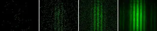

See this simple experiment
dblslphot
Single-photon camera recording of photons from a double slit illuminated by very weak laser light. Left to right: single frame, superposition of 200, 1’000, and 500’000 frames.
to understand how photon wave functions interfere and show the interference fringes expected by light, even though the individual footprint is a dot in (x,y,z,t). The wave nature of photons is a probability wave, it needs an accumulation of photons to appear.
