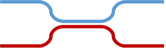

Suppose there are two different single mode nanophotonic waveguides. The two waveguides are gradually bent and become adjacent to each other to form a coupler. enter image description here
Two classical electromagnetic waves propagating along the two waveguides can couple to each other. For two photons, can they show the two photon interference effect in this structure?
If they can, how to calculate the probability that exactly one photon is detected at each exit, taking into consideration that the two waveguide eigenmodes have different field distributions?

Firstly, the optical field can have a spatial distribution, even though we observe them as point particles called photons. The spatial distribution is the wave functions that gives us a probability amplitude to observe a photon at a certain location. For multi-photon state, the situation can become a bit more complicated when we start to make correlated observations, because of the possibility for entanglement. The wave function of the photon represents its spatiotemporal properties.
For the waveguide structure, one can assume that it behaves as a beamsplitter. If we can assume that the probability for a photon to jump to the other guide is equal to the probability to stay in the guide in which it arrived, then one should be able to observe Hong-Ou-Mandel (HOM) interference, which is a form of two-photon interference. The effect of the HOM interference depends on the spatiotemporal properties of the wave functions. In a single-mode guide, the spatial properties are fixed and only the temporal properties would play a role.
If the spatiotemporal properties in the two guides are exactly the same, one would find that both photons would always exist from the same guide. On the other hand, if they have different spatiotemporal properties, one can find that two photons can exit from the two different guides. There combined state would be an entangled state, the singlet Bell state. Due to the entanglement, this state is not a classical state and can therefore not be described by the classical optics.
