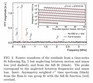

The rest-frame lifetime of the muon is about two microseconds. Take a look at the inset to the figure below from the paper you link, the sub-graph with the seven squiggly lines:
muon decay data
That is a histogram: it shows the relationship between the number of decay electrons observed and the amount of time the muon beam has spent in the storage ring, going as many as seven laps around. I count about 140 precession periods on the figure. The result is precise enough to be interesting entirely because that plot is so lovely.
